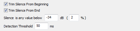

Trim Silence remove silence from beginning or end,

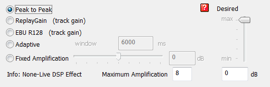

Volume Normalize adjust volume in many different ways,

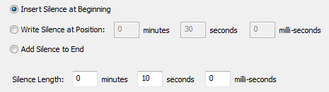

Write Silence insert silence,

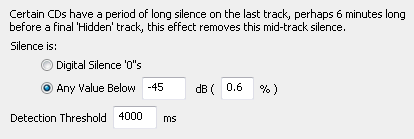

Audio CD - Hidden Track Silence Removal
Audio CDs can have a 'hidden' last track which is really the last track with a long period of silence before the hidden track. This effect removes the silence period, set the Detection Threshold large enough to ignore periods of silence normal tracks might contain.

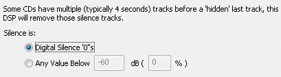

Audio CD - Silence Track Deletion
Certain Audio CDs have a 'hidden' last track which is proceeded by many small silence tracks, this effect detects and removes those tracks which as silence (R13 or newer required).

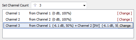

Channel Mapper
Channel Mapper sets a desired number of channels, each channel can be edited, choosing which source channel(s) it is made up from. In the above example Channel 1 and 2 are left untouched, and channel 3 is created from the sum of 0.5x channel 1 and (inverted) 0.5x channel 2.

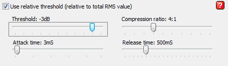

Dynamic Range Compression
Compresses the dynamic range to level-out large changes in audio level and give the audio a "tighter" sound. This DSP is a so-called "hard-knee compressor" and can be used to reduce the effects of over-produced jingles or adverts in combination with under-produced speech (e.g. in Podcasts).
A relative threshold can be applied which makes the threshold level, at which the compressor starts working, relative to the file's overall RMS value. When using a relative threshold, the threshold value should be in the range -1 to -6dB for the best results. When using a fixed threshold (i.e. not relative), the value could be quite a bit lower (in the range -3 to -30) depending on the audio content.
The compression ratio determines how much gain reduction will be applied above the threshold level.
The attack time is the time it takes the compressor to respond to audio level increases above the set threshold level. If this is value is too high, the compressor will let through transient peaks of audio. A short attack time is recommended.
The release time is the time that the compressor takes to reduce the gain reduction (or recover) after an decrease in audio level below the set threshold level. A too short release time could give undesirable pumping effects. It is better to use quite a high value for this ( > 500 mS).

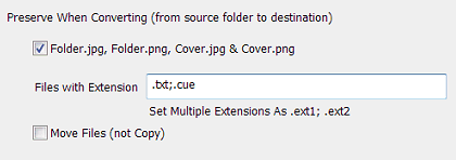

Folder.jpg Preserve
Copies Folder.jpg to the destination folder when converting. Also it is possible to copy other file based on their extension (example .txt; .cue  to copy all files with these extensions, or a fixed filename, such as log.txt).
The option to Move Files can be used in conjunction with the Delete Source DSP effect to remove all source files. When moving test on a small subset of files before letting loose on your whole collection.

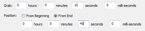

Grabber
The purpose of Grabber is to extract audio from a larger file, the amount to be grabbed is entered into Grab and the position grabbing should start into the file, either from the beginning or end. In the above example 10 seconds of audio is grabbed 45 seconds from the end.

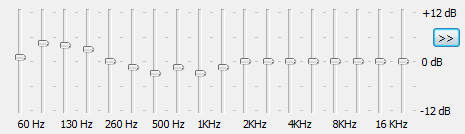

Graphic Equalizer
Graphic Equalizer boosts or reduces selected frequencies. 0 dB leaves the frequency untouched, +12 dB increases the frequency effectively by x4 and -12 dB is divide by 4. Care must be taken when increasing frequencies as clipping can occur (where the signal goes over maximum allowed), so if possible reduce other frequencies, leaving the frequency to boost at 0 dB.
>> Offers a menu to Load, Save and select Preset equalizer values. Also is the option to adjust single bars (without a check moving one bar moves the ones next to also).

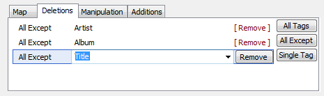

ID Tag Processing
ID Tags can be manipulated by:
  • Map: copy a tag to another name, for example copy Artist to Album Artist. The original tag value is left untouched, if it should be removed use Deletion,
  • Deletions: it is possible to remove All Tags, All Except listed, or delete a Single Tag value,

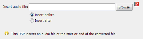

Insert Audio
Inserts an audio file (any format which is supported by dBpoweramp) to either the front or end of a converted file.

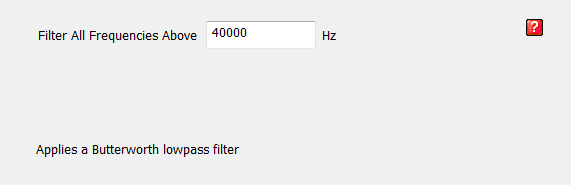

Lowpass
Applies a filter to the specified frequency, so that all frequencies above this point are filtered. This filter is not a hard cut off filter, it is applied gradually affecting frequencies around the spefied point. An example usage of this filter is with the DSD decoder codec, where it might be decoded to 176KHz, a 40KHz filter can be applied to remove all harmful ultrasonics from DSD.

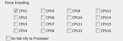

Multi-CPU Force
Requires Reference & R13 or above (R14 or above for more than 4 CPU support). By default Music Converter / CD Ripper will encode using the maximum number of CPUs available, unless an audio format has a high disk I/O usage (such as wave), in which case only 1 CPU is used. This effect can override the automatic choosing of CPU and allow perhaps just CPU2 to be used (on a dual core system). Do Not Ally to Processor can be used to allow the encoder to jump between CPUs (if only 2 CPUs are chosen then it will only use 2 encoders, but will jump between any available CPU). All 4 CPUs are shown even on systems with less than 4 CPU cores.

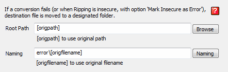

Move Destination File on Error
It is possible to separate files with conversion errors. The specific applications of this DSP effect are:
  • Secure ripping to separate insecure files (when used with the secure option in CD Ripper to 'Mark Track as Error if Insecure')
  • If there is a possibility the source file is corrupted (perhaps a lossless file).
A Root path is set (could be the same location as the original file) or a fixed location. Naming again can include the original filename, or can be constructed from ID Tag elements such as [artist] - [title].

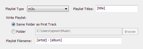

Playlist Writer
Writes a Playlist file: .m3u, .pls or .m3u8 (unicode m3u) containing all files converting or ripping. Playlist Titles specifies the title assigned to a track in the playlist.
Playlists can be written to the same folder as the tracks, or a designated folder. The actual filename is set by Playlist Filename.

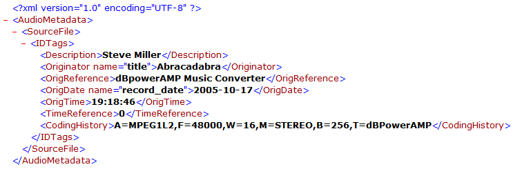

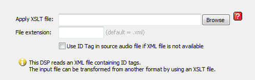

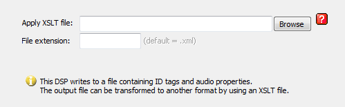

Read Metadata File
This DSP imports metadata from an external XML file, by default (with Apply XSLT blank) all ID tags are imported from the standard XML file (see below). A template can be used to transform data from other XML structures, to do this set Apply XSLT to the template file you want to use. See the example XSL templates in \dBpoweramp\DSPs\XSLT import.
XML input data should have the following format (either as the input file or after applying an XSLT template):
The tags in the <IDTags> node can have any XML compliant name and can also include an attribute (e.g. name="title"), which may include spaces. If the "name" attribute is available, this will be the ID Tag name in the destination sound file. If the attribute is not available, the tag name will be used.
IMPORTANT NOTE: The XML data must always be encoded using UTF-8.

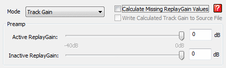

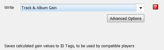

ReplayGain
ReplayGain calculates the average loudness of audio files, with a compatible player all tracks will sound the same loudness. A compatible player is required as ReplayGain values are written to the ID Tags, the audio is untouched.
There are two types of Replay Gain:
  • Track Gain: volume levels are calculated for the track in question,
  • Album Gain: calculated levels are for the whole album, an intentionally quiet track remains so.
The Write option specifies which tags are written, including iTunes compatible tags.

ReplayGain (Apply)
Replay Gain calculates the average loudness of audio files, with a compatible player all tracks will sound the same loudness. This effect was created mainly for the dBpoweramp Audio Player, so certain options have no relevance to audio conversion. This effect will apply ReplayGain to the destination file based on an already calculated ReplayGain ID Tag (should be present in the source file), it is ideal for creating files which are ReplayGain'ed for use on Players which are ReplayGain incompatible. If the Source files have no ReplayGain values use the effect 'Volume Normalize' which calculates and applies in one go.
Mode sets which type of ReplayGain tag to use, Track or Album Gain.
Calculate Missing ReplayGain Values has no meaning for audio conversion and should be unchecked.
Preamp can be used to set a lower target volume, inactive ReplayGain refers to source files with no ReplayGain tags.

Trim Silence
On some tracks there is silence present at the beginning or end of the track, this DSP effect can detect and remove such silence. Detection Threshold sets the minimum time average audio levels have to go over the set silence value before it is classed as non-silence. If Trim Silence is eating audio it should not, enter a lower dB value, such as -44.
This effect is non-live.
Trim
Remove a set length of audio from the beginning or end of the file. This effect relies on the correct audio length to be detected before decoding (if trimming from end).
Volume Normalize
There are 5 different ways of adjusting the volume of an audio track:
  • Peak to Peak: simplest volume normalize, the peak (or maximum) value is found and the whole track volume is adjusted so that peak touches the desired volume,
  • ReplayGain: a more advanced normalization, the average loudness is calculated and the volume is adjusted. This method does not use ID Tags to store ReplayGain values, rather the audio is adjusted. If a Replay Gained track is played next to a non-Replay Gained track, it will sound quieter, as Replay Gain requires head-room to prevent clipping.
  • EBU R128: a newer standard of ReplayGain, the average loudness is calculated and the volume is adjusted. This method adjusts the audio. Internally the audio is calculated to a -23LUFS level, it can be adjusted with the dB scale on the right.
  • Adaptive: the best way to describe adaptive, is like having your hand on the volume knob, constantly adjusting it up and down (a window is used to detect loudness) to compensate for quiet parts, ideal for creating a track to play in a noisy environment (such as car).
  • Fixed Amplification: Amplifies the audio by a fixed amount, +6 dB is x2, where -6 dB is divide by 2, be careful not to clip audio (go over the maximum).
Maximum Amplification sets a limit on the amount of amplification applied (set too high, on adaptive and silence will become noise).
Desired Volume can be set higher than 0 dB (which is maximum), setting 12 dB is 4x the maximum, use with care otherwise the signal will clip.

Write Metadata File
Exports the metadata to an external file, by default (with Apply XSLT blank) all fields are exported to an XML file. A template can be used to limit fields, set Apply XSLT to the template file, see the example templates in \dBpoweramp\DSPs\XSLT
Write Silence
Silence of a specified length can be inserted at the beginning, appended to the end, or written to any part of the track.
